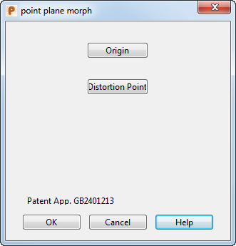

    Point/Plane morph dialog
    Use this to edit a morph that was created using a point and a plane.

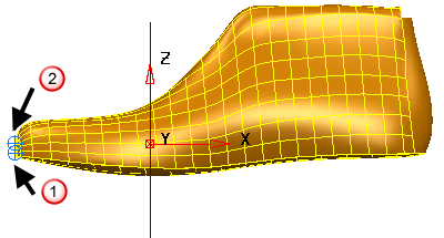

    When this dialog is displayed, the following are drawn:
    • the origin .
    • the distortion point .
    • the workplane.
    You edit the positions of the origin and distortion points, but not the workplane.
    Use the options on the dialog as described in Surface Morphing dialog — Point/Plane.
