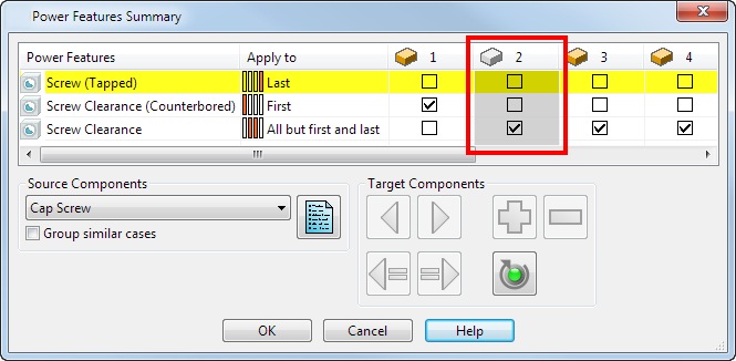

Identifying selected target components in the Power Feature Summary
You can use the Power Feature Summary dialog to confirm that the Power Features will only be generated for the selected targets:

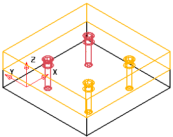

  1. Select your source and target components:
  2. Click Assembly tab > Power Features panel > Generate to display the Generate Power Features dialog:
  3. Select Summary to display the Power Features Summary dialog.
    Any unavailable intersections, where Power Features will not be generated, are displayed in grey:
