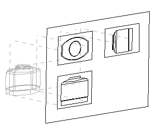

Different views of a model are created by looking at a model from different directions. You can have many views on a drawing, each showing a different projection of the model.
You can also edit a model through a view on a drawing.
The drawing below shows views of different projections of a model:
