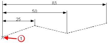

    • Basepoint dimensions — a group of dimensions measured from a common origin (basepoint) to different endpoints:
      Basepoint

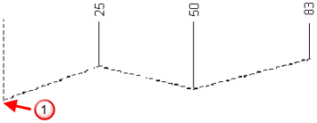

    • Ordinate dimensions — a group of dimensions created along an axis of the principal plane of the current workplane. These dimensions measure distances from a common origin:
      Origin point

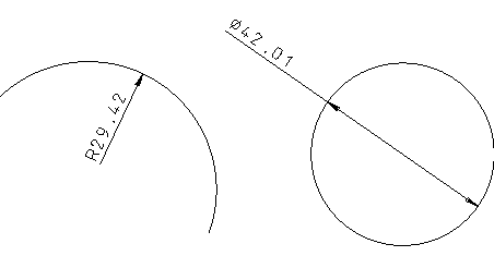

  • Radius/diameter dimensions — measure the radius or diameter of an arc or a circle:
