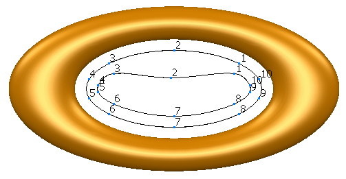

The closed curve morphing method, with In Projection deselected, works best for surfaces that lie entirely outside or on the reference curve.

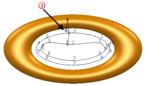

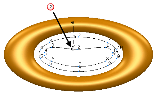

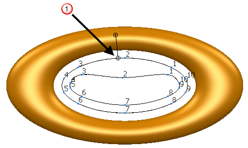

- For each point on the selected curve, the closest point on the reference curve is identified
- A distance and direction is defined from the point on the reference curve to the point with the same number on the control curve
- The point on the surfaces to be morphed is moved by this distance and direction, reduced by any decay that you may have defined

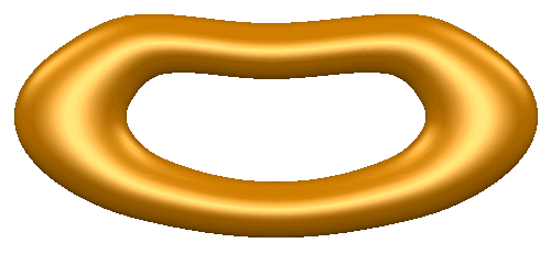

- Click on OK to produce the result below.
