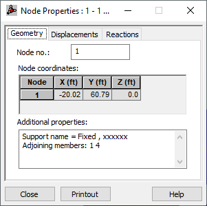

Click the Geometry tab in the Bar Properties dialog to display the following:
Using Node number, you can select a node:
  • Graphically, by clicking the node in the structure view
  • Entering the bar number in the field
Note: You cannot change the node number in this dialog.
The tab provides the following information:
  • Node number in the edit field.
  • Node number and coordinates in table format (You cannot change node coordinates).
  • Additional properties displays the following data, that you cannot change, describing a node.
Support - Support name and support code
Adjoining bars - Number of bars adjoining the selected node
Compatibilities - Name of the compatibility type and number of the compatible node
Rigid links - Name of the rigid link type and number of the master node
Note: The list of additional properties displays only those attributes that have been applied to the selected node.
