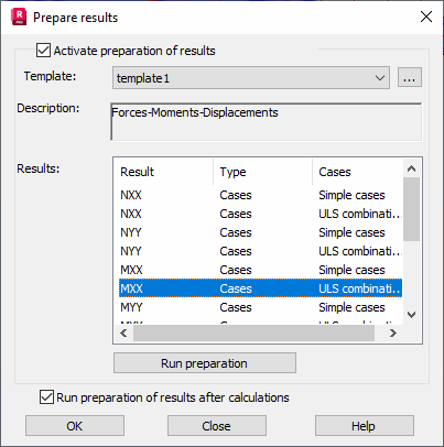

In either plates/shells or volumetric structure types, select Analysis > Prepare Results for defining result preparation for map display.
The dialog includes the following information:
- A template name.
- A short template description.
- A list of results to be calculated.
There are four standard templates with basic result sets available.
To calculate results, click Run preparation or activate the Run preparation of results after calculations option. When calculations of a structure model complete, result preparations will start automatically.
You can create user defined templates for preparing results. To start defining a new template, click (...). The Composition of Template for Result Preparation dialog opens.

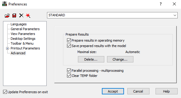

The option to toggle default preparation of results for the display of maps is available in the Preferences dialog on the Advanced tab.
To assure the correct functioning of the "Prepare result" module, it is required to check the "Prepare results in operating memory" and "Parallel processing - multiprocessing" checkboxes in Tools/Preferences/Advanced.
To provide availability of generated results straight after opening the file, it is necessary to turn on the "Save prepared result with the model" option in Tools/Preferences/Advanced and save the file with .rtd extension.
It is highly recommended to check all checkboxes in Tools/Preferences/Advanced to ensure correct functioning of the 'Prepare results' module, as shown below.
