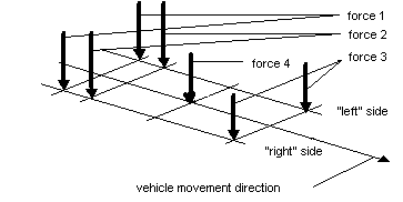

A set of forces is defined for a vehicle as shown in the following image.

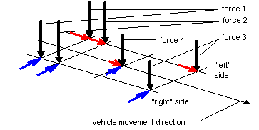

Defining the following coefficients:
VL = 1.0
VR = 1.0
HL = 0.0
HR = 0.2
LL = 0.1
LR = 0.0
Results in the following values of forces:
Force 1: VL = 1.0, VR = 1.0, HL = 0.0, HR = 0.2, LL = 0.1, LR= 0.0
Force 2: VL = 1.0, VR = 1.0, HL = 0.0, HR = 0.2, LL = 0.1, LR= 0.0
Force 3: VL = 1.0, VR = 1.0, HL = 0.0, HR = 0.2, LL = 0.1, LR= 0.0
Force 4: VL = 1.0, VR = 1.0, HL = 0.0, HR = 0.1 (average of the values HL and HR), LL = 0.1 (average of the values LL and LR), LR= 0.0
For this polyline, the load takes the shape as shown in the following image.
