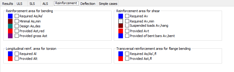

Once the Reinforcement tab is selected in the Diagrams dialog box accessed from the Results menu, the dialog box below will appear on the screen.
In the above dialog box, the following values may be selected for presentation:
in the Reinforcement Area for bending
- Theorein the Reinforcement Area for bendingtical (required) Abt
- Real (provided) Abr (resulting from the actual distribution of the longitudinal reinforcement)
in the Reinforcement Area for shear force
- Theoretical (required) Ast
- Real (provided) Asr (resulting from the actual distribution of the shear reinforcement).
Additionally, areas for longitudinal reinforcement against torsion and transversal reinforcement against flange bending may be presented.
Note: A color with the help of which the value will be presented on the diagram is shown beside each of the mentioned values.
