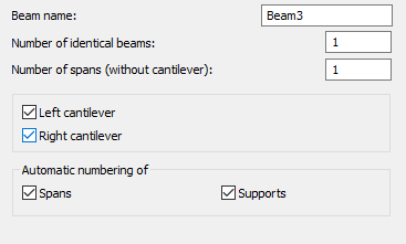

The dialog box shown below appears on the screen after defining basic data of an RC beam, selecting RC beam with varying spans and pressing the >> button.
The dialog box above enables definition of the following parameters:
- Beam name - field for defining a name of a whole beam
- Number of identical beams - field for specifying a number of identical beams to be defined (important in bills of materials)
- Number of spans (without cantilever) - field for defining a number of beam spans (right and/or left cantilevers are disregarded)
- Right and left cantilevers - if these options are switched on, then a cantilever is added on the left and / or right side of an RC beam
- Automatic numbering of spans and supports - if these options are switched on, then spans and /or supports of a defined RC beam are automatically given numbers (names).
After pressing theNext >button, the user moves on to the next dialog box where parameters of the cross sections for individual spans of an RC beam may be determined.

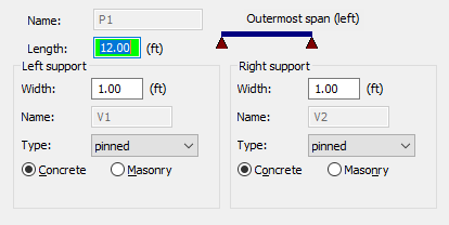

The following span types are available:
left cantilever
outermost span (left)
middle span
outermost span (right)
right cantilever.
In the above dialog box the user may specify the name of a designed span (active span) and basic information about the span geometry: span length and parameters of span supports (width, name of the right and left supports, support type: pinned, fixed or roller as well as type of material from which the support is to be made: concrete support or masonry support). There are also the Torsion not consideredoptions available in the above dialog box. If they are activated, then for a selected support torsion will be ignored.
After pressing theNext >button the program proceeds to defining elevation parameters of the next span in an RC beam.
