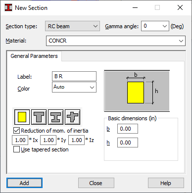

For example, the New Section dialog for an RC beam displays as shown in the following image:
The Section dialog lets you:
- Select the beam section type (rectangular, T-shaped, I-shaped, T-shaped with flanges positioned lower) and specify its dimensions.
- Specify section name. By default, Robot enters a section name composed of a few letters denoting the section type and the dimensions of the cross-section.
- Select the color of the section.
You can select 1 of 4 types of beam/continuous footing sections: rectangular, T-shaped, I-shaped, and T-shaped with lower-positioned flanges. The dialog displays the parameters for the type of section selected. The previous dialog shows the parameters for a rectangular section. Similar options are displayed in the dialog when a T-shaped section is selected. After a T-shaped section with lower-positioned flanges is selected, 2 additional tabs display in the dialog: Slabs and Cuts.
Selecting the Use tapered section option, assigns linearly-varying cross-sections to a beam by specifying in the h2 field, a value of the height at the right end of the selected segment.
