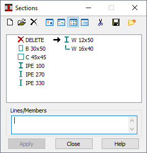

This option assigns sections to structure members. Open the Sections dialog using any of the following:
- Click Geometry menu > Properties> Sections.
- Click
- From the SECTIONS AND MATERIALS layout.
The Sections dialog assigns sections to structure members directly. It has:
- Active list field - List of sections defined by a user. These sections can be assigned to structure members.
- Active selection field (Lines/Members) - Displays the current selection of structure members. Any section from the active list can be assigned to the selected members.
- Standard buttons (Apply, Close, and Help).
The active list has information about the label and the section type.
The following icons are at the top of the dialog.
- Adds a new section type or lets you select a section from a section database (New Section Definition).
- Lets you select a section from a section database (Selection of a member section from an available section database).
- Deletes a section type from the active list.
, and
- Displays the list of active section types as: large icons, small icons, a short list, or as a full list.
- Deletes all section types from the active list that are not in the structure.
- Lets you save the section highlighted in the active list to a database. When clicked, the
Save to database dialog opens, which lets you select the database for saving the section.
- Opens the
Label Manager dialog.
When the full list is selected, the parameters of the sections are displayed:
- If x displays in the second column, this section has already been used in the structure.
- The default material for the section displays in the third column.
- The value of the Gamma angle displays in the fourth column.
