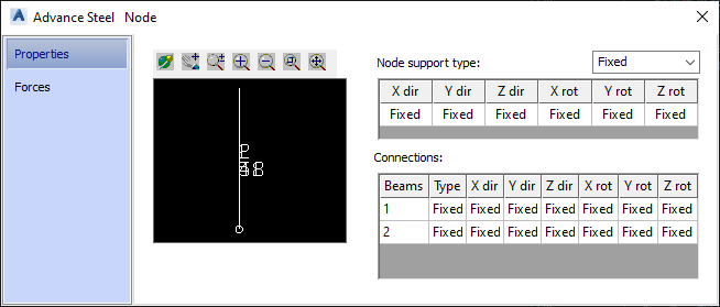

To view the node information, right-click the node mark (in the following image, in the red box) and select Advance Properties from the context menu.
In the Node dialog, the Properties tab contains information about supports and releases.

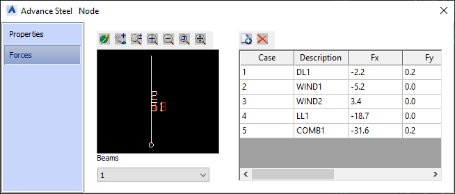

The Forces tab displays values of internal forces.
