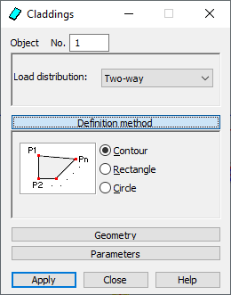

Use the option to define claddings. Select the Geometry menu > Claddings to access the option.
The following dialog displays then.
The dialog has 4 parts:
- Object field (displays the number or identifier of the created or selected object) and the Load distribution field (selects a load distribution type: two-way, one-way X or one-way Y)
- Definition Method
- Geometry
- Parameters.
When the Claddings dialog is fully opened, then clicking one of the 3 buttons (Definition Method, Geometry, or Parameters) minimizes the corresponding part of the dialog so it displays only the options used at a given time. When the window is minimized, clicking one of the button extends the dialog.
Definition method selects a method of defining a cladding (Contour, Rectangle or Circle); selecting one of these options determines the definition method.
