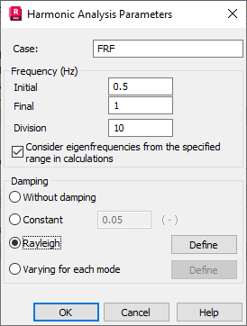

Use the Harmonic Analysis Parameters (FRF) dialog to specify parameters for the analysis of harmonic vibrations in the frequency domain (FRF) for a load case.

Case
The name of the load case.
Frequency
Select a type of frequency:
  • Initial: The first interval of the frequency domain.
  • Final: The last interval of the frequency domain.
  • Division: The number of steps that the interval is divided into. The harmonic analysis is performed at each step and the results are saved.
  • Consider eigenfrequencies from the specified range in calculations: Considers points at which eigenvibration frequencies occur as well as the points which result from the division of the frequency interval.
Mass matrix
Select a type of mass matrix:
  • Consistent: complete matrix - always with regard to rotational degrees of freedom.
  • Lumped with rotations: diagonal matrix - with regard to rotational degrees of freedom.
  • Lumped without rotations: diagonal matrix without rotational degrees of freedom.
Damping
Specify the damping parameters for the harmonic analysis:
  • Without damping: Ignores damping during the analysis.
    Note: For calculations which consider eigenvibration frequencies in the structure, ignoring damping can lead to indeterminate results caused by resonance.
  • Constant.
  • Rayleigh: Uses the eigenvalues and material damping to calculate the results. Click Define to set up the Rayleigh Damping parameters.
  • Varying for each mode: Uses predefined damping values for each mode. Click Define to specify the damping values for each mode.
