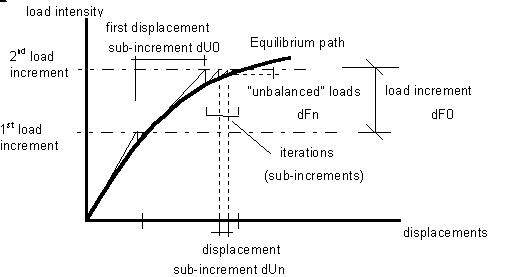

With the incremental method, the right-hand load vector is divided into n equal increments. A consecutive load increment is applied to the structure once the state of equilibrium for the previous increment is achieved. The norm of unbalanced forces is specified for each step, allowing for monitoring of the structure force-deformation relations.
The following figure shows an example of a nonlinear process using the incremental process. The values used for non-linear calculations are displayed.
The load increment is used when dividing a load into smaller segments. For complex structures where the impact of non-linear effects is considerable, it is possible that calculations do not converge if the analysis for the value of a load is applied in one step. The number of load increments influences the number of calculation iterations. The greater the number of increments, the greater the probability for the calculations to reach the point of convergence.
