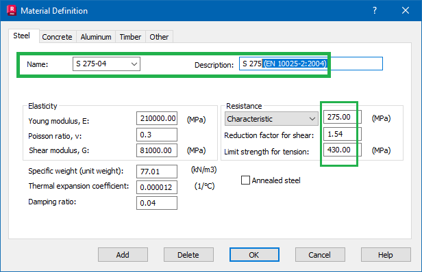

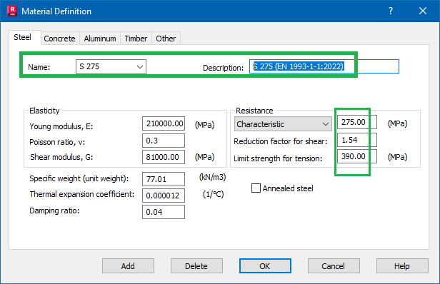

Note: The material database has been modified. From version RSA2026 it is possible to select materials dedicated to design code. Details are described in
Description section on the page Start a Project/Set the Job Preferences/Job Preferences Dialog/Select Materials for the Project/Steel
