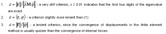

Two types of residual vectors are defined:
where {φ, λ} designate calculated eigenpairs which include certain calculation errors. The first expression defines a residual vector in terms of forces, whereas the second one defines terms of displacements.
Three different criteria of estimating calculation errors for eigenvectors are applied:

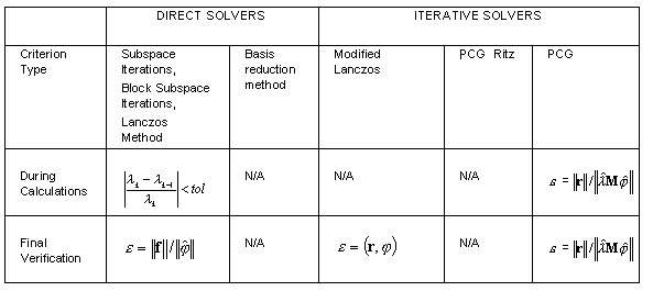

Methods
Comments
  • Precision during structure calculations for the Lanczos and modified Lanczos methods (iterative solver) for pseudo mode is not determined. Only final verification is performed.
  • Convergence check at each of the 20 Lanczos steps for seismic mode is conducted. The tol parameter in the Modal Analysis Parameters dialog is ignored.
  • Basis reduction and PCG_Ritz are the Ritz methods. Precision verification is not performed. The tol parameter in the Modal Analysis Parameters dialog is ignored.
  • PCG for iterative solver applies the most stiff convergence criteria during calculation. The tol Parameter in the Modal Analysis Parameters - Iterative Solver dialog defines the top bound for ε, thus ε ≤ tol is a condition for stopping iterations.
Precision should not be confused with the tolerance determined in the Modal Analysis Parameters dialog while using skyline or sparse direct solvers, if modal mode is selected. Tolerance during calculations is defined according to the following formula.
where λk, λk-1 - two successive eigenvalues on k, k-1 iteration steps and tol denotes the tolerance, adopted in the Modal Analysis Parameters dialog . Determining the final accuracy of calculations (1-3) is time-consuming and performed at the final stage of modal analysis to verify obtained precision. Decrease tol tolerance to increase calculation accuracy which increases the iteration number.

DIRECT SOLVERS
ITERATIVE SOLVERS
Subspace iterations, block subspace iterations, Lanczos method
Basis reduction method
Modified Lanczos
PCG_Ritz
PCG
Decrease tol in the Modal Analysis Parameters dialog
Increase number of basis nodes and basis directions
Decrease the tol in Iterative Solver Parameters dialog and increase the number of modes
Increase the number of modes
Decrease the tol value in Modal Analysis Parameters dialog
