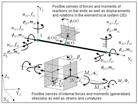

  2. Geometry, kinematics and strain approximation
    Geometry, sign convention for forces, displacements, stresses and strains
    Basic kinematic relationships

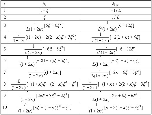

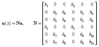

    Displacement approximation
    When there is a possibility to consider shear influence and consistence of results obtained for the linear element, physical shape functions considering shear influence have been implemented.
    2D bars:
    Shape functions and their derivatives are expressed by the formulas:
    where:
    x = x / L
    for planes XY and XZ, respectively.

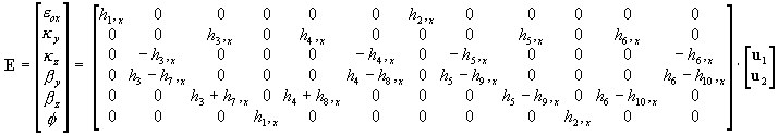

    Kinematic relationships for the matrix notation (the geometrically linear theory)
    When considering the influence of imposed strains
    Increment of generalized (sectional) strains:
    2D:
    3D:
    where:

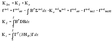

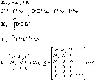

    Nodal force vector and element stiffness matrix
    Algorithm on the element level
    The element geometry is not modified; the local-global transformation is performed with the use of initial transformation matrix 0 T
    Large displacement option
    It is a certain variant of bar description allowing for large displacements. The approach of the updated Lagrange description is applied here.
