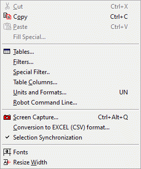

Contextual menu
Several options are available from the Tables contextual menu, such as filtering, content management, or resizing options.
Right-click in the table to access the contextual menu.
Tables
Opens the Tables: Data and Results dialog which allows you to display or hide a selection of tables.
Filters
Opens the Filtering dialog which allows you to select which data you want to dsplay in the table.
Special Filter
Opens the Nodal value selection dialog which allows you to access advanced filtering options.
Table Columns
Opens the Nodal value selection dialog which allows you to select which data you want to include in the table.
Note: Select the desired parameters from the dialog, and then click OK to add or replace existing columns.
Units and Formats
Opens the Job Preferences dialog which allows you to change the default units for the project.
Robot Command line
Allows you to use commands in the program.
Fonts
Allows you to change the style of the column or row headers as well as the general style of the table.
Resize width
Resizes the column to the default width.
Note: You can change the width of a column by moving its right margin.
