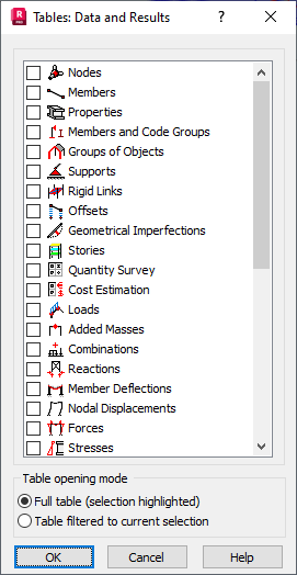

The Tables: Data and Results dialog lets you select tables for the presentation of data or calculation results.
- Access
- Click
View
Tables
- Click Tables from the context menu
- Click
- Click
View
- Dialog elements
- Data tables
Node table
Member table
Table of section properties
Table of members and groups used in structure designing
Table of structure supports
Table of rigid links
Table of offsets
Material table - (not currently available)
Table of geometrical imperfections
Table of structure stories
Table of data set (quantity survey) and cost estimate
Cost estimation table
Load table
Added mass table
Combination table
Panel table
Solid table.
You can select the following types of data tables:
- Results tables
Reaction table
Member deflection table
Node displacement table
Force table
Stress table
Table with results of the dynamic analysis of a structure (eigenvibrations)
Structure buckling analysis result table
Pseudo-static force value table
Time history analysis result table
Solid result table
Plate and shell result table
Plate and shell reinforcement result table
Table with results of theoretical (required) reinforcement for RC members
Table with reduced results for plates and shells
Table with results of the plastic process history.
You can select the following types of results tables:
- Table opening mode
The following options at the bottom of the dialog specify how the data or results tables are opened:
- Full table (selection highlighted) - When selected, the entire (full) table is opened. The rows that are assigned to the selected nodes, members, or objects are highlighted.
- Table filtered to current selection - When selected, only the rows assigned to the selected nodes, members, or objects are displayed.
Note: If you display a results table, and there are no current structure calculation results, Robot automatically begins structure analysis and calculates the selected quantities.See also:
