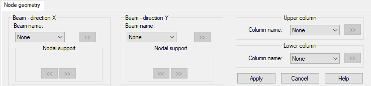

Node Geometry
Click or select Structure > Definition in the Beam-column nodes module to begin defining node geometry. To generate a node, elements that will be included in it (beams and columns) need to be defined beforehand.
To generate an RC node:
  • Select a beam name from the drop-down lists for the directions X and Y.
  • Select a name of the upper and the lower columns.
The >> button (positioned next to the selection lists) defines the offset for a selected element.
For RC beams, names of nodal supports may be defined. Names are congruous with names of supports of a beam in the beam module. After all elements are defined, click Apply. A node model will display on the screen.
