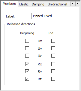

When the Members tab is selected, the New Release Definition dialog is displayed.
To define a new release, assign a label, and select the released degrees of freedom at the beginning and the end of the member element:
Beginning
End
UX
When this option is selected, the displacement along the X axis in the beginning node of the member element is released.
When this option is selected, the displacement along the X axis in the end node of the member element is released.
UY
When this option is selected, the displacement along the Y axis in the beginning node of the member element is released.
When this option is selected, the displacement along the Y axis in the end node of the member element is released.
UZ
When this option is selected, the displacement along the Z axis in the beginning node of the member element is released.
When this option is selected, the displacement along the Z axis in the end node of the member element is released.
RX
When this option is selected, the rotation about the X axis in the beginning node of the member element is released.
When this option is selected, the rotation about the X axis in the end node of the member element is released.
RY
When this option is selected, the rotation about the Y axis in the beginning node of the member element is released.
When this option is selected, the rotation about the Y axis in the end node of the member element is released.
RZ
When this option is selected, the rotation about the Z axis in the beginning node of the member element is released.
When this option is selected, the rotation about the Z axis in the end node of the member element is released.
Clicking Add, adds the new release to the list of active releases.
