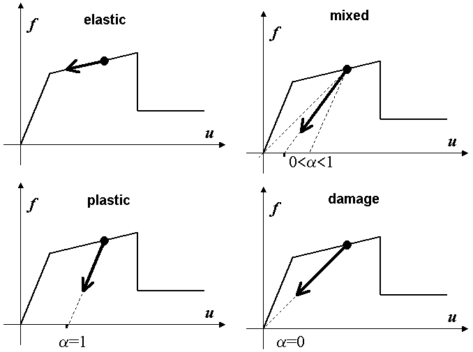

In the plastic analysis, the unloading method also needs to be specified. It determines the path of a material's behavior after the yield strength is exceeded during unloading, when deformations become smaller. (The deformation gradient is negative.) There are 4 types of material behavior (see the following image):
- Elastic - Return along the same path as when loading. For the non-linear material model, this is non-linear elasticity.
- Plastic - Return along the path defined by the initial modulus of elasticity. The value of parameter is α = 1.
- Damage - Return along the path directed to the point (ε,ς) = (0,0). The value of parameter is α = 0.
- Mixed - Return along the intermediate path between the plastic path and damage path specified by the parameter α : 0< α < 1.
