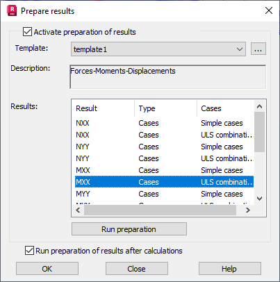

In either plates/shells or volumetric structure types, select Analysis > Prepare Results for defining result preparation for map display.
The dialog includes the following information:
  • A template name.
  • A short template description.
  • A list of results to be calculated.
There are four standard templates with basic result sets available.
To calculate results, click Run preparation or activate the Run preparation of results after calculations option. When calculations of a structure model complete, result preparations will start automatically.
