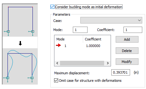

Use this dialog to generate a structure model which includes deformations induced by a selected buckling mode or linear combination of modes.

Consider buckling mode as initial deformation toggles consideration of deformation for a structure. When off (default), all options in the dialog are inaccessible. If on, options in the dialog are accessible and structure deformation parameters can be defined. Click Apply to accept the change (switching on or off deformations). Click Close to diregard changes.
The Parameters field includes the Case selection list containing buckling cases defined for a structure. Buckling deformations are based on a selected buckling case. The Mode and Coefficient fields determine the number of a buckling mode and the coefficient with which the selected mode will be included in a linear combination. The mode and coefficient may also be selected from the list of modes and coefficients. Click on a selected line on the list enters the mode number and the coefficient to the Mode and Coefficient fields. Adding, deleting and modifying elements are possible by clicking the appropriate button. Note that adding an element results in the overwriting of old values.
Deformations can be scaled after defining a value in the Maximum displacement field. The value enables scaling a selected mode or mode combination.
If the Omit case for structure with deformations option is deselected, a given buckling case will be calculated for a deformed structure. If selected, the case will be omitted during calculations.
