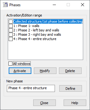

The following options are available in the Phase structure dialog.
  • Activation/Edition range - The field where the names of defined structure phases will be displayed. Beside each of the defined phases are the number and a toggle for bar/element transfer to other phases. The defined bars/elements in the currently selected phase will also be included in the phase for which the transfer has been switched on. If off, the bars/elements defined for the currently selected phase will not be included in the given phase.
  • All windows - Activation of a phase of the structure will refer to all the viewers open in the program. If off, the phase activation will refer to the active viewer.
  • Activate - Activates the selected phase. This is also achieved by double-clicking a structure phase.
  • Modify - Changes the name of the selected structure phase.
  • Delete - Deletes the selected structure phase.
  • New Phase - Defines a new structure phase. Enter a name and click Define. The defined phase will receive the next number.

  1. Define a structure phase in the dialog. The phase is moved into the Activation/Edition range field.
  2. Select the phase in the list and click Activate. The phase becomes active.
