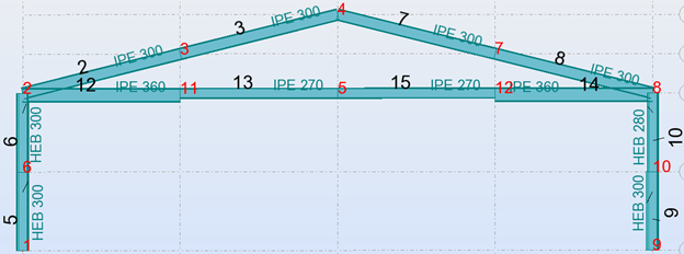

Examples of splice connections in a structure
In a structure such as the one above, the following connections can be found.
Node | Bars | Type | Compatible Connections |
3 | 2, 3 |
Beam Splice ![]() |
All types of plates |
7 | 7, 8 |
Beam Splice ![]() |
5 | 13, 15 |
Beam Splice ![]() |
11 | 12, 13 |
Beam Splice ![]() |
Web plates, bars offset |
12 | 15, 14 |
Beam Splice ![]() |
6 | 5, 6 |
Column Splice ![]() |
10 | 9, 10 |
