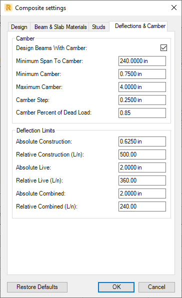

Camber settings
  • Design beams with camber.
    Select this option to use camber in beam design. If you deselect this option, the camber-related settings on the tab are inactive.
  • Minimum Span To Camber
    Specifies the minimum beam length to which camber is applied.
  • Minimum Camber
    Minimum allowable camber. If optimum camber is lower than the minimum, no camber is used.
  • Maximum Camber
    Maximum allowable camber. If more than the maximum camber is required a larger beam is used.
  • Camber step
    The minimum allowable increment by which to optimize camber.
  • Camber Percent of Dead Load
    The percent of the dead load applied to the beam that is compensated for with camber. The default value is 80 percent.
  • Deflection Limits:
    • Absolute and relative construction.
    • Absolute and relative live.
    • Absolute and relative combined.
    Use these settings to specify absolute and relative limits for deflection due to construction, live, and combined loads. See Deflections.
