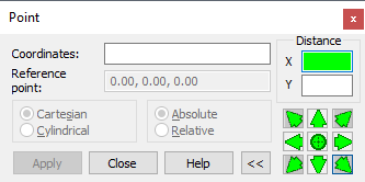

Open the Point dialog using one of the following methods:
  • Click Tools menu > Point coordinates.
  • Click the field displaying the cursor coordinates in the status line.
  • Pressing the 0 key on the keyboard.
The dialog lets you define point coordinates relative to a selected reference point or in absolute values. Use the Coordinates field to define Cartesian or cylindrical (polar) point coordinates. This option can be used to define coordinates of nodes, bars, contours, and other objects. Note that the Reference point field displays the coordinates of the recently defined point. If a reference point is a specific point of an existing model, you can define (redefine) a node in that point.
Pressing >> expands the dialog; pressing << restores the original size of the dialog. The right of the dialog shows options for defining point coordinates or a distance from the reference point.
The bottom right corner of the dialog includes the following icons:
- Defines point coordinates
, , , and - Determines the distance between a point being defined and the reference point in the direction of the axis of a selected plane (such as, X or Y).
, , , and - Determines the distance between a point being defined and the reference point in the direction of two axes of a selected plane (such as X and Y).
Coordinates should be defined using the following format:
  • Cartesian system: (x, y, z)
  • Cylindrical system: (r, j, z).
