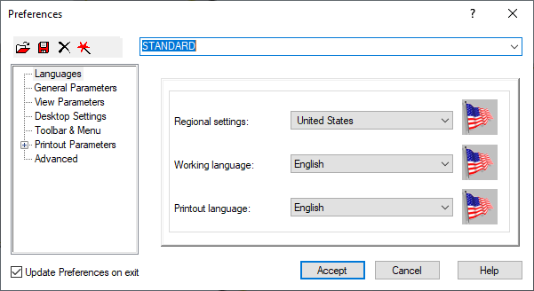

After you click LANGUAGES in the Preferences dialog, you can select the regional parameters and the working language to use.
You can select the following:
Regional Settings
Specifies the regional settings for the following countries:
Great Britain
United States
France
Canada
Australia
India
Germany
Poland
Italy
Spain
Russia
Romania
Portugal
Holland
Belgium
Brazil
China
Japan
Greece
Norway
Denmark
Finland
Ukraine
Thailand.
Regional settings adjust the following parameters to the standards of a country:
  • National codes
  • Materials
  • Regulations.
Note: When you change the regional parameters, you also change the working and printout language selections.
Working Language
The following working languages are available:
English
Polish
French
Italian
Russian
Spanish
Romanian
Japanese.
Chinese
Brazilian Portuguese
Printout Language
The following printout languages are available:
English
Polish
French
Italian
Chinese
Spanish
Romanian
Russian
Japanese
Brazilian Portuguese.
