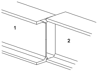

An example of an automatic offset definition and the results from assigning it to a structure bar is shown in the following image.
The automatic offset has been assigned to the bar 2.

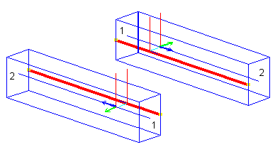

For 3D structures, orientations of the local system axes depend on a position and the orientation of a bar element; therefore, the same offset defined in a local system might give a different effect in the global system. This effect is shown in the following image. The 2 parallel bars show different orientation (the beginning of the bar is 1 and its end is 2). This bar definition causes the orientations of local x and y axes to be opposite. As a result, the same offset by Vpy value (that is, by one-half of the section width) in the local system results in the opposite section shift in the global system.
