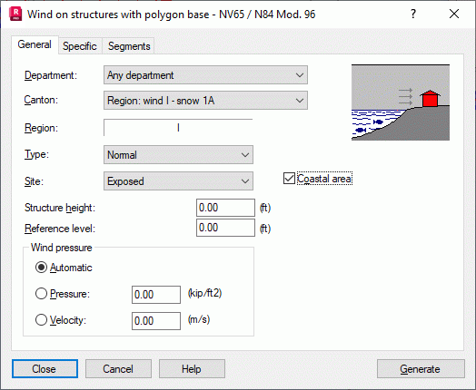

After clicking Parameters in the Snow/wind loads dialog, the following displays:
The dialog has 3 tabs:
  • General
  • Specific
  • Segments.
General tab
You can specify the following parameters on the General tab:
  • For the French code:
    • Department in which a structure is to be constructed.
    • Canton of the department. After the department and canton are selected, the Region field automatically shows the wind region.
    • Wind type - Defines the basic dynamic pressure used in calculations of a wind load on a structure.
    • Site - A list with 3 values: obscured, normal, and exposed. Based on the site parameter, the value of k5 coefficient is determined.
    • Coastal area - When selected, the value of qH/q10 coefficient is constant.
    • Reference level - Specifies the distance between the lowest point of the selected structure part and the ground. The default value is zero, which means the structure lies directly on the ground.
    • Wind pressure - Defines the value of basic wind pressure. When Automatic is selected, the pressure is determined based on the department, canton, and site. When Pressure is selected, a field becomes available where you can enter the wind pressure (the value will not increase because of the effect of the site). When Velocity is selected, you should specify the wind velocity (expressed in m/s) in the field. The velocity is converted to pressure by applying the following formula: q = v2 / 16.3.
  • For the American code:
    • Exposure category: A, B, C, or D
    • Building category: I, II, III, or IV
    • Turning on/off the Hurricane prone region. The previous 2 parameters listed are used for the basis of determining the value of the importance factor (when Automatic is selected). After Manual is selected, you can specify the value of the importance factor.
    • Basic wind velocity - Determines the basic value for wind velocity, which depends on the structure's geographical position.
    • Structure height - Specifies the highest point in the structure above the reference level. If this value is zero, it means the structure is positioned directly on the ground.
