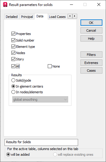

Select the Data (solids) tab in the Columns dialog to select solids quantities for presentation.
Volumetric element nodes, properties, solid numbers and element types can be selected for presentation.
Results in a table can be presented in the following orders.
  • Solid/node - solid/node/case
  • In element centers - element/case
  • In nodes/elements - node/element/case.
Results can be in the form of averaged values between elements, though it is available only for the order solid/node. Smoothing (averaging of values) can be performed by selecting one of the options from the given list at the bottom of the dialog.
