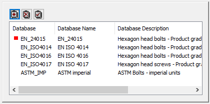

To access the bolts or anchor bolts databases:
  1. Click Tools Job Preferences Databases.
    The Job Preferences dialog opens.
  2. Select Bolts or Anchor bolts in the left panel of the Job Preferences dialog.
Currently active bolt databases are listed in this dialog. Organize the list with the following tools:
Click this button to add a new bolt database.
Click this button to delete the selected bolt database.
Click this button to set the currently selected database as the default.
