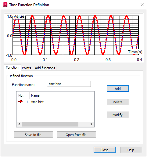

New. - Select Time History in the Analysis Type dialog, and then click OK.
- Click Function definition in the Time history analysis dialog.
Dialog elements
This dialog contains three tabs: Function, Points, and Add functions.
Function tab
Use this tab to define the name of the time function.
Points tab
Use this tab to define the points of the time function.
Add functions tab
Use this tab to add two functions together.
