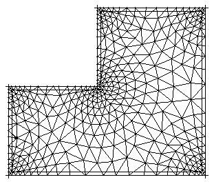

EXAMPLE 1
L-shaped slab
FE mesh will be created for an L-shaped slab.

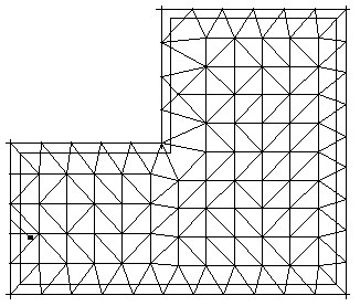

Mesh 1
In the Meshing Options dialog:
  • for Available meshing options, select Delaunay
  • for Mesh generation, select User, and for Division 1, type 10
  • for Delaunay method parameters, select Delaunay
  • for Finite elements, select 3-node triangles
  • for the remaining parameters, accept the default settings.
The resulting mesh is shown below.

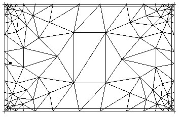

Mesh 2
  • for Delaunay method parameters, select Kang (Hmax=1000, Q=1.2), default emitters checked out (H0=0.3)

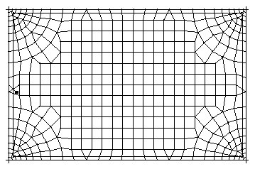

Mesh 3
  • for Delaunay method parameters, select Delaunay+Kang (Hmax=1000, Q=1.2), default emitters checked out (H0=0.3)
  • for Finite elements, select 4-node quadrilaterals

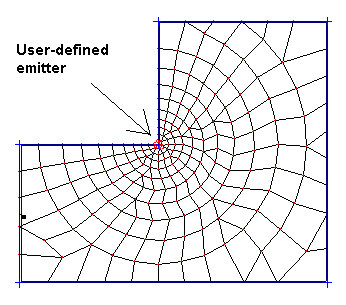

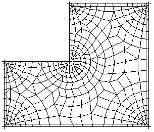

Mesh 4
  • for Delaunay method parameters, select Delaunay+Kang (Hmax=1000, Q=1.2), user's emitters - as shown in the drawing (H0=0.3), default emitters not checked out

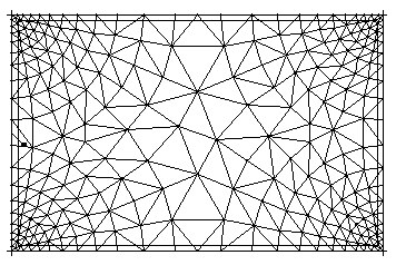

Mesh 5
  • for Delaunay method parameters, select Delaunay (Hmax=1000, Q=1.2), emitters not checked out

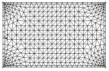

Mesh 7
  • for Delaunay method parameters, select Delaunay+Kang (Hmax=10, Q=1.5), default emitters checked out (H0=0.3)
