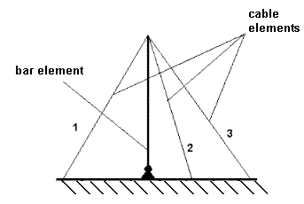

Frequently, a user defines the tension force of a cable less than the load (such as self-weight) acting on it; in such cases it is known that there is no physical solution to this model. A similar problem concerns the static model displayed in the following image.
The model which is displayed can be a model of a whole structure or a part of a larger structure. If in the definition of a cable, random values of the assembly tension forces are assigned to cables numbers 1, 2 and 3, then most likely it will be impossible to fulfill the equilibrium conditions for the horizontal direction (the total for the horizontal components of tension forces from all three cables would need to be equal or close to zero). Therefore, the calculation process for this structure is not convergent or calculation errors occur. Such errors are typical of abnormally large displacements and rotation angles of structure nodes (to fulfill the equilibrium conditions, abnormally large rotation angles are defined in the structure, which frequently results in exceeding the domain of the functions: acos, asin, or root).
Therefore, in the initial stage of calculations, it is best to define cables by specifying the cable length instead of the tension forces. Only after becoming familiar with approximate values of tension forces, can you determine the values of tension forces for reasonable values of cable length, keeping in mind that the equilibrium conditions should be fulfilled at least approximately in nodes similar to those in the model shown in the image above.
