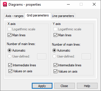

Grid parameters
The following dialog is displayed after the Grid parameters tab is selected in the Diagrams - properties dialog.
The options in this dialog let you determine the parameters of an auxiliary grid for X and Y axes shown on diagrams:
  • Logarithmic scale - Turns on/off the logarithmic scale for a given axis.
  • Main lines - Turns on/off the presentation of grid main axes on diagrams.
  • Number of main lines - Determines the number of main lines presented on diagrams.
  • Intermediate lines - Turns on/off the presentation of grid intermediate axes on diagrams.
  • Values on axis - Turns on/off the display of coordinate values on axes.
