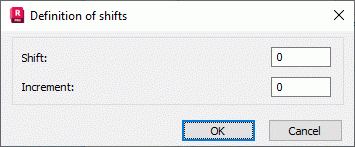

An initial shift value is entered to the Shift edit field. Increment parameter determines the number of iterations performed during modification of the shift. For example, if the increment is 5 and the convergence of an arbitrary eigenvalue is not obtained within 5 iterations, then the shift value will be changed in the manner shown by the following formula.

  • If shift = 0 and increment ≥ 0, then the initial shift value equals zero
  • If shift ≥ 0 and increment = 0, then the shift value is constant during all subspace iterations
  • If shift = 0 and increment = 0, then the shift is not considered and Kσ = K.
