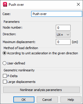

Use this dialog to set up Pushover Analysis parameters for a dynamic case.
- Access
- Ensure that a modal analysis has already been defined.
- Click Analysis
Analysis Types
New.
- Select Push over in the Analysis Type dialog, and then click OK.
- Case
- The name of the load case.
- Parameters

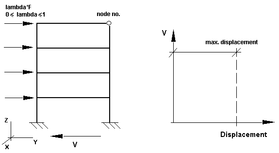

- Node number - The number of a structure node belonging to the structure roof (see the figure below).
- Direction - Direction of an external factor affecting the structure in the global coordinate system.
- Maximum displacement - Maximum displacement in the selected structure node.
- Method of load definition
- According to unit acceleration in the given direction - Determines a displacement vector during the pushover analysis.
- User-defined.

- Geometric nonlinearity
- P-Delta - Select this option to consider P-Delta effects during the analysis.
- Large displacements - Select this option to take into account large displacements and/or rotations during the analysis.
- Nonlinear analysis parameters - Opens a dialog which allows you to set up the options of the nonlinear analysis.
