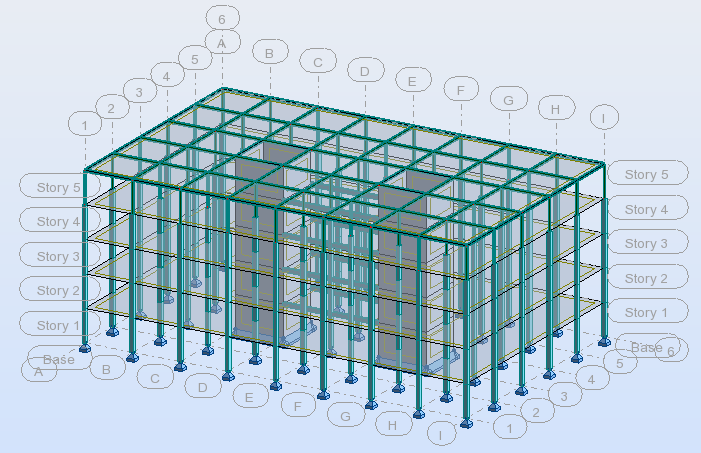

Create a Structural Model
In this tutorial, you learn how to create a structural axis and stories on which you define your structure.
This tutorial guides you through the following tasks.
  • Add columns, beams, walls, and a floor with openings for the shafts.
  • Copy elements to other stories.
  • Change the columns of the top floor from reinforced concrete to steel.
  • Add beams from column to column.
This tutorial should take about 30 minutes.
The final version of the structure is shown below.
