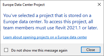

Review the following information if you receive a warning when accessing a Revit 2021.1 model in P&ID Modeler that is stored on a Europe data center.
Issue: In Revit 2021.1, when you select a Plant 3D Collaboration project that is stored on a Europe data center, you receive the following warning.
