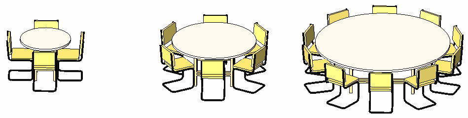

Create Tables
The following function demonstrates how to load a family of Tables into a Revit project and create instances from all symbols in this family.
The LoadFamily() method returns false if the specified family was previously loaded. Therefore, in the following case, do not load the family, Table-Dining Round w Chairs.rfa, before this function is called. In this example, the tables are created at Level 1 by default.
Code Region 12-3: Creating tables
void CreateTables(Autodesk.Revit.DB.Document document)
    String fileName = @"C:\ProgramData\Autodesk\RVT 2014\Libraries\US Imperial\Furniture\Tables\Table-Dining Round w Chairs.rfa";
    // try to load family
    Family family = null;
    if (!document.LoadFamily(fileName, out family))
        throw new Exception("Unable to load " + fileName);
    // Loop through table symbols and add a new table for each
    ISet<ElementId> familySymbolIds = family.GetFamilySymbolIds();
    double x = 0.0, y = 0.0;
    foreach (ElementId id in familySymbolIds)
        FamilySymbol symbol = family.Document.GetElement(id) as FamilySymbol;
        XYZ location = new XYZ(x, y, 10.0);
        FamilyInstance instance = document.Create.NewFamilyInstance(location, symbol, StructuralType.NonStructural);
        x += 10.0;
The result of loading the Tables family and placing one instance of each FamilySymbol:
Figure 47: Load family and create tables in the Revit project

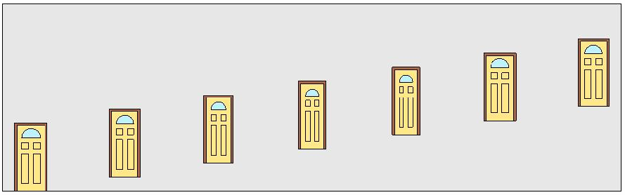

Create Doors
Create a long wall about 180' in length and select it before running this sample. The host object must support inserting instances; otherwise the NewFamilyInstance() method will fail. If a host element is not provided for an instance that must be created in a host, or the instance cannot be inserted into the specified host element, the method NewFamilyInstance() does nothing.
Code Region 12-5: Creating doors
void CreateDoorsInWall(Autodesk.Revit.DB.Document document, Wall wall)
    // get wall's level for door creation
    Level level = document.GetElement(wall.LevelId) as Level;
    FilteredElementCollector collector = new FilteredElementCollector(document);
    ICollection<Element> collection = collector.OfClass(typeof(FamilySymbol))
                                                .OfCategory(BuiltInCategory.OST_Doors)
                                                .ToElements();
    IEnumerator<Element> symbolItor = collection.GetEnumerator();
    double x = 0, y = 0, z = 0;
    while (symbolItor.MoveNext())
        FamilySymbol symbol = symbolItor.Current as FamilySymbol;
        XYZ location = new XYZ(x, y, z);
        FamilyInstance instance = document.Create.NewFamilyInstance(location, symbol, wall, level, StructuralType.NonStructural);
        x += 10;
        y += 10;
        z += 1.5;
The result of the previous code in Revit is shown in the following picture. Notice that if the specified location is not at the specified level, the NewFamilyInstance() method uses the location elevation instead of the level elevation.
Figure 48: Insert doors into a wall

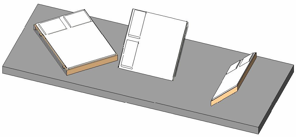

Create FamilyInstances Using Reference Directions
Use reference directions to insert an item in a specific direction.
Code Region 12-6: Creating FamilyInstances using reference directions
public void CreateWithRefDir(Document document)
    // Get a floor to place the beds
    Floor floor = collector.OfClass(typeof(Floor)).FirstElement() as Floor;
    if (floor != null)
        // Find a Bed-Box family
        FilteredElementCollector famCollector = new FilteredElementCollector(document);
        famCollector.OfClass(typeof(Family));
        ICollection<Element> collection = famCollector.ToElements();
        foreach (Element element in collection)
            if (element.Name.CompareTo("Bed-Box") == 0)
                family = element as Family;
                break;
        if (family != null)
            // Enumerate the beds in the Bed-Box family
            FilteredElementCollector fsCollector = new FilteredElementCollector(document);
            ICollection<Element> fsCollection = fsCollector.WherePasses(new FamilySymbolFilter(family.Id)).ToElements();
            IEnumerator<Element> symbolItor = fsCollection.GetEnumerator();
            int x = 0, y = 0;
            int i = 0;
                XYZ location = new XYZ(x, y, 0);
                XYZ direction = new XYZ();
                switch (i % 3)
                    case 0:
                        direction = new XYZ(1, 1, 0);
                        break;
                    case 1:
                        direction = new XYZ(0, 1, 1);
                        break;
                    case 2:
                        direction = new XYZ(1, 0, 1);
                        break;
                FamilyInstance instance = document.Create.NewFamilyInstance(location, symbol, direction, floor, StructuralType.NonStructural);
                x += 10;
                i++;
The result of the previous code appears in the following picture:
Figure 49: Create family instances using different reference directions
