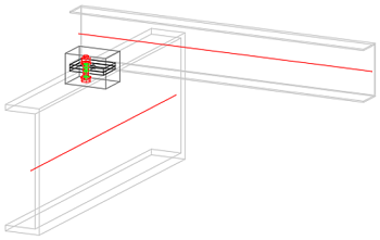

Associate Connections with Profile Sizes
Associate connections with profile sizes by using ranges of applicability attached to the connection types.
Learn how to automatically create structural steel connections which rely on rule-based solutions according to standard provisions or company good practice guidelines.
