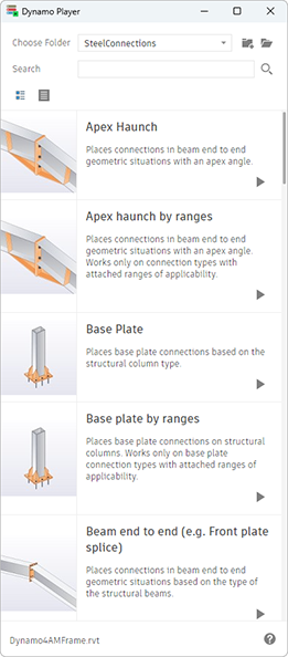

The list of steel connections sample scripts will appear in Dynamo Player:

Note: The Steel Connections functionality remains unchanged. Sample scripts created with versions prior to 2021 can be used without restrictions or other changes. Load the sample scripts into Dynamo Player, from: C:\ProgramData\Autodesk\RVT 2022\Dynamo\samples\<language-folder>\Revit\SteelConnections.
- Click Manage tab ➤ Visual Programming panel ➤ Dynamo Player.
- In the Dynamo Player dialog, click
(Browse to folder). - In the Browse to Folder dialog, navigate to the directory containing Dynamo scripts.
