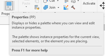

Ribbon tooltips
When you hold the cursor over a tool on the ribbon, by default Revit displays a tooltip. The tooltip provides a brief description of the tool. If you leave the cursor over the ribbon tool for another moment, additional information displays, if available. While the tooltip is visible, you can press F1 for context-sensitive help that provides more information about that tool.
Note: If you press F1 before the tooltip displays, the default help topic opens instead of the appropriate context-sensitive help topic. Wait for the tooltip to display before pressing F1.
These tooltips are useful when you are first learning how to use the software. You can adjust the amount of information displayed in tooltips or how quickly the information displays. You can also turn off the tooltips when you no longer need them.
Some tooltips include embedded videos, called ToolClips™. These videos use motion to show how to use the tool. They play automatically when you display the tooltip. To see an example, display the tooltip for Modify tabModify panel (Trim/Extend to Corner).
