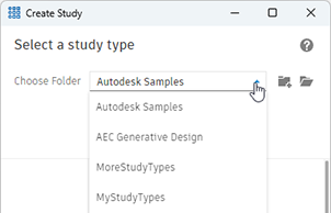

  4. For Choose Folder, use the drop-down list to select the folder that contains the desired study type.
    Sample study types reside in the Autodesk Samples folder.
    If you need to add a folder to the list, click Add Folder. See Manage Folders for Study Types.
    When you choose a folder from the list, the Create Study dialog lists the available study types.
    Note: A study type consists of the DYN file and its associated Dependencies folder. Both must reside in the selected folder before the study type displays in the Create Study dialog.
