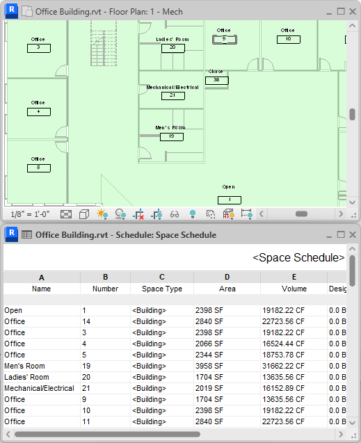

Creating a space schedule is the same as creating any type of schedule in Revit.
Note that you must select Spaces for Category in the New Schedule dialog. See Create a schedule or quantity
A floor plan (with spaces) and the corresponding space schedule
