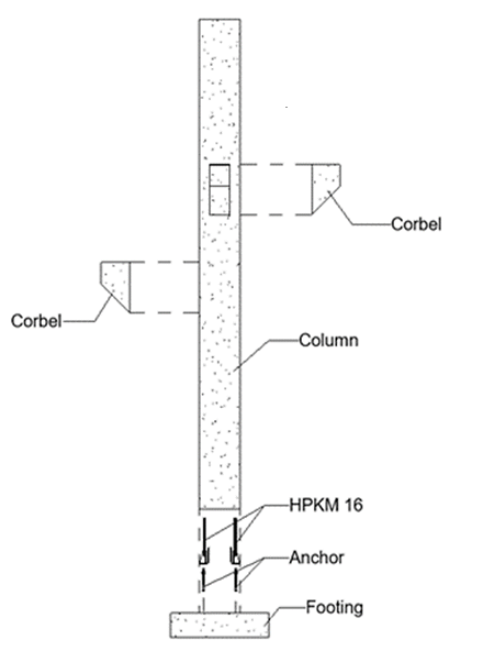

A displacement set refers to the selected element, or multiple elements being used by the Displace Elements tool to create an displaced view (similar to an exploded view). Displacement sets are:
- moved by drag controls along their X, Y, and Z axes
- edited to add and remove its elements, and
- reoriented using the ViewCube
A displacement set can be comprised of one, or several elements, and has one set of drag controls that is used to position it in the view. The displacement set in the following image includes several elements (Structural Foundation, Basic Roof, Curtain Wall: Storefront, Grids, and System Panel: Glazed).
